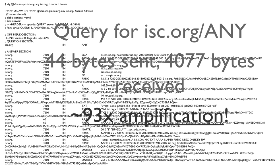

DNS servers make surprisingly good amplifiers. Figure 2-1 shows a simple example:
If a user makes a DNS query for “isc.org/ANY”, the query is 44 bytes long, and the response is 4077 bytes long. That is around 93 times amplification!
Figure 2-1: Amplification example of querying isc.org/any
This example and some simple math show how devastating amplification can be. Say an attacker is generating queries with a botnet (a network of independent hosts, or bots, infected with malware) , and each bot has a measly 1 Mbps connection to the Internet: With a 1 Mbps connection, each bot could send the 44 byte query from the previous example approximately 2909 times per second.
Because each query results in a response that is 4077 bytes, you can calculate that the DNS server has to come up with about 93 Mb each second.
If the botnet contains 11 bots all doing the same thing, that’s a total of over 1 Gb that the DNS server is supposed to send out every second of the attack!
