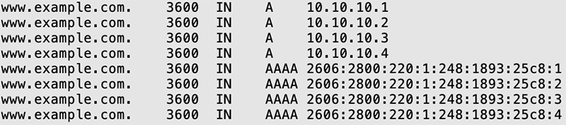

In modern DNS systems though, we are increasingly seeing resource record sets (or RRsets) that have a larger combined size. For example, Figure FAQ-5 illustrates querying for www.example.com may yield results such as this (AAAA are IPv6 records):

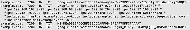

Or the same query might return the following TXT records, each providing a specific function such as spam detection or site verification as demonstrated in Figure FAQ-6:
