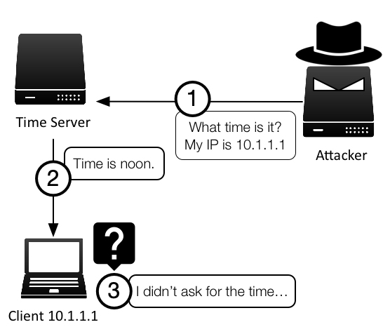

DNS Weakness 1: UDP
Being a mostly UDP-based protocol has its advantages: It is a lightweight protocol in comparison to TCP, tends to run faster, and is less resource intensive. However, UDP is much easier to spoof than TCP, meaning an attacker can craft a UDP packet with any source IP address easily. Figure 2-3 illustrates this type of source IP address spoofing that is easily accomplished with UDP. This type of source IP spoofing is also known as “reflection”, is discussed in more detail in DDoS Attacks.
Figure 2-3: UDP Reflection
UDP Reflection

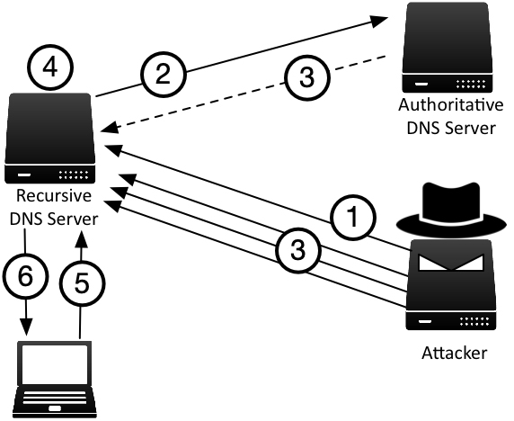

Figure 2-4 illustrates how this weakness was leverage in the well-published cache poisoning attack discovered by computer security researcher Dan Kaminsky in 2008.
Figure 2-4: Cache Poisoning Attack, or “Kaminsky Attack”.
  1. The attacker has prior knowledge of the target domain and sends a query to the recursive DNS server for a name that does not exist, such as q0001xxx.example.com
  2. Because this is a name that does not exist, the recursive DNS server must traverse the DNS namespace to find it.
  3. The attacker can beat the legitimate NXDOMAIN response from the authoritative name server, by sending a lot of spoofed responses that look like they are coming from the legitimate example.com authoritative name server. In the spoofed response, attacker claims www.example.com is the NS record of the domain, to trick the recursive name server into accepting www.example.com and its IP address.
  4. By the laws of probability, the attacker’s spoofed response may be accepted by the recursive server, and the bad answer www.example.com is now stored in its cache.
  5. Unsuspecting client queries for the name www.example.com A record.
  6. The recursive server provides the answer from the now-poisoned cache with the forged answer from the attacker.
A well-crafted Kaminsky attack can insert a bogus entry in the cache within minutes. He discovered new the vulnerability in the DNS protocol, and he used this to create cache-poisoning of records that aren’t even in the attack query by exploiting the Authority section and the inherent and necessary use of sending A records (called Glue records) when returning NS records for name servers. To make matters worse, the attacker could choose to poison an NS record itself, thus taking command of an entire domain rather than just a single entry.
