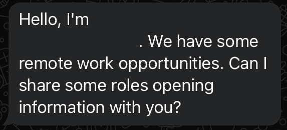

Imagine my luck when I received an out-of-the-blue WhatsApp message from an unknown number. In my case a simple “Hello,” part of a probing exercise that doesn’t show their hand if I were to ignore the message or tell them where to go.
Clearly making a good impression on this (likely) automated process by responding, it was straight down to business. With them posing as a recruiter, I was politely asked (Figure 1) if I would like more information about some remote work opportunities.
![Figure 1: Can I scam you? [WhatsApp message]](https://www.infoblox.com/blog/wp-content/uploads/work-hard-pay-harder-figure-1.png)

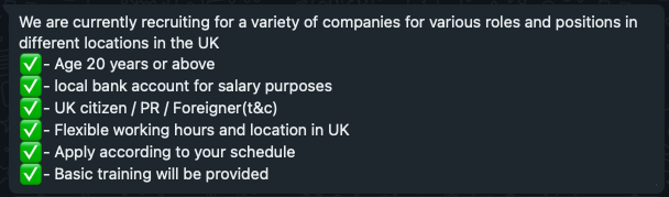

After being provided with their checklist (Figure 2), a step less about finding top-quality job candidates and more about finding suitable victims, the scammer, or more likely their automated process, hands me over to a seemingly human agent to gain further trust and reel me in.
![Figure 2: Desired victim checklist [WhatsApp message]](https://www.infoblox.com/blog/wp-content/uploads/work-hard-pay-harder-figure-2.png)

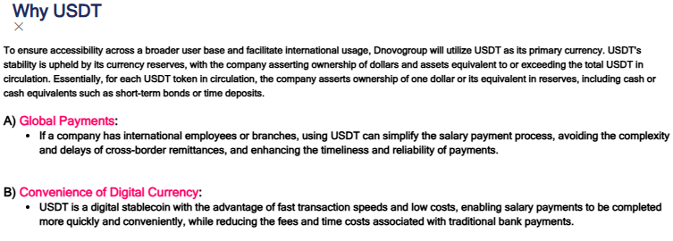

We expect scammers to avoid traditional payment methods because bank transfers can be tracked and potentially reversed. As for why Tether is the scammer’s cryptocurrency of choice, they attempt to provide an explanation within the scam portal (Figure 3).
![Figure 3: Explanation of why to use harder-to-track USDT [Scam portal]](https://www.infoblox.com/blog/wp-content/uploads/work-hard-pay-harder-figure-3.png)
This is, of course, all part of the illusion of legitimacy. The scammer likely prefers Tether as it is pegged almost one-to-one with the U.S. dollar, making it easy to understand for those of us unfamiliar with crypto-markets and avoiding the volatility of Bitcoin (BTC).

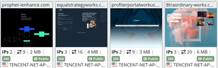

Starting with the IP addresses that the portal domain resolved to (Figure 4), it was evident that hundreds of similarly structured domains were active at any one time, mimicking numerous brands.
![Figure 4: Example IP pivot linked to additional scam domains [URLScan]](https://www.infoblox.com/blog/wp-content/uploads/work-hard-pay-harder-figure-4.png)
Consistent with the scammer’s current theme, the majority of these observed brands were operating in the digital marketing, e-commerce and SEO industries. It was also evident that the scammer is not focused on abusing brands or targeting victims in any particular country or region. Abused brands were observed to be headquartered across Asia, Europe and North America, many of which also had a global presence. This allows the scammer to target victims with a brand that would appear plausible should anyone conduct due diligence checks.
Digging deeper into the registration records and the IP addresses these domains resolved to, it became clear that the scammer has specific preferences when setting up their scam domains:

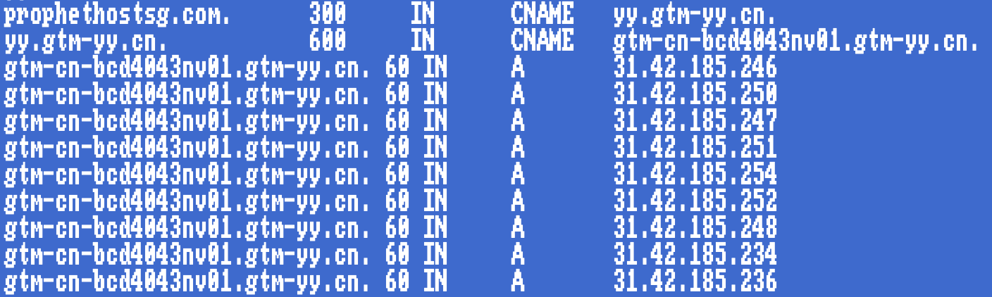

The first indication of second-tier infrastructure I encountered was the discovery of DNS CNAME records (Figure 5) mapping to just a handful of domains, their own content delivery network (CDN) of sorts.
Figure 5: I dig it, totally!
Having (dig) dug into a large number of domains identified through my earlier pivots, and armed with the CNAME records, it was time to delve into passive DNS (pDNS) and other data sources to determine what else might have been pointing their way.

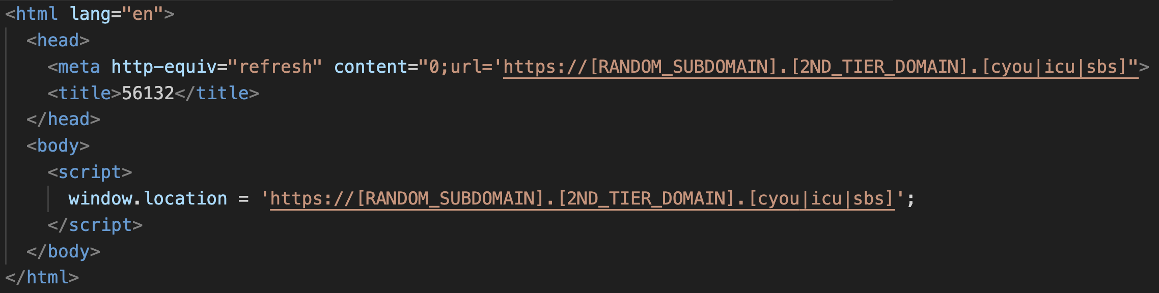

In many cases, and seemingly when using Cloudflare to front their scam domains, I observed sites redirecting visitors with either an HTTP 302 response or a combination of HTML and JavaScript (Figure 6).
Figure 6: HTML and JavaScript redirection
These redirections, similar to the CNAME method, take victims from the recognisable brand-mimicking domain to subdomains and domains that appear to be created by a registered domain generation algorithm (RDGA) and are predominantly under the top-level domains (TLDs) “.cyou,” “.icu” and “.sbs.” The structure and pattern of these domains suggest the use of automated tools to create and register them in bulk.
The reasons for mixing and matching the methods of getting victims to their second-tier infrastructure are not clear at this point. Aside from the management and resilience advantages, a few working theories include:

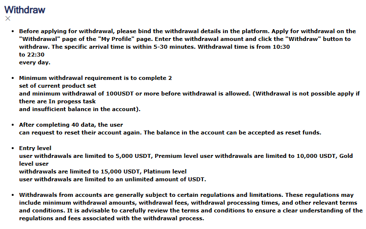

We’re not talking small numbers either, with the portal’s Withdraw help page (Figure 8) mentioning Tether amounts of 5,000 USDT, 10,000 USDT and 15,000 USDT: likely target amounts to try and squeeze out of each victim.
![Figure 8: Good luck withdrawing anything like these amounts [Scam portal]](https://www.infoblox.com/blog/wp-content/uploads/work-hard-pay-harder-figure-8.png)
