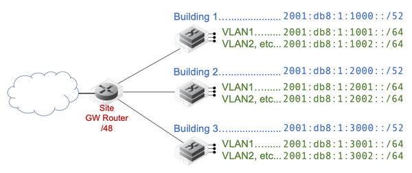

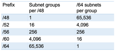

For larger, more complex, and more hierarchical sites, organizing those 65,536 /64s in some fashion could help maintain or even improve operational efficiency. For example, let’s imagine a site comprised of a campus network with several (let’s say 10) buildings. Using nibble boundaries (if you’re unclear on what a nibble boundary is, please review part one of this blog), 16 bits of a /48 can be allocated in the following manner:
Each nibble boundary results in a group of prefixes with a number of /64 subnets. As we might infer, allocating more nibbles to provide a greater number of prefixes (e.g., /52, /56, /60, etc.) results in each of those available prefixes having fewer /64 subnets to assign to interfaces.
Using our example of a campus network site, we can proceed by counting the number of buildings we need prefixes for and determining which of the nibble boundaries provides a sufficient supply. From the above table, it’s apparent that any of the prefix sizes – /52, /56, or /60 – would provide enough prefixes. In case it’s not obvious, we exclude a /64 from the running given that choosing it would result in having to sequentially or randomly assign /64s without regard to site structure as in our description above.
Since a /52, /56, or /60 would all work given only 10 buildings, which do we choose? To help answer that, it might help to consider what level of growth, if any, we anticipate in the number of buildings. Ten buildings would consume 63% of the available pool of /52s (with each /52 providing 4,096 /64s). An often-used capacity planning principle when it comes to IPv6 prefixes is to move up to the next largest pool of subnets when consumption of the existing pool of subnets exceeds 75% (or in our example, 13 buildings requiring 13 /52 prefixes). Choosing a /56 prefix size would provide enough /56 prefixes for 256 buildings. But remember from the table that as we increase the number of prefixes we reduce the number of /64s available to assign to interfaces for each of those prefixes. For example, by the time we get to the /60 level, we could have 4,096 /60 prefixes but each would only give us 16 /64s for interface assignments – very likely an insufficient number given the networks typically found in a campus network building.
To complete our example, we’ll assume that we don’t anticipate any growth (i.e., additional buildings) at our site and that a /52 is the prefix size we wish to use for all buildings. From this choice we can proceed to planning our address assignments. Here’s an example showing the beginning of numbering for the first three buildings.
You’ll notice that the prefixes assigned provide unambiguous identification of both the site (e.g., 2001:db8:1::/48), each building (e.g., 2001:db8:1:1000::/52), and each interface assignment (e.g., 2001:db8:1:1001::/64). Such identification can be particularly useful when troubleshooting network issues. By always adhering to nibble boundaries in IPv6 assignment, such operationally beneficial identification is ensured.
