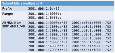

In an instance where we are required to troubleshoot a network issue involving any of these non-nibble prefixes, we can’t rely on the first three hextets alone to precisely identify the entity a particular prefix is assigned to. Rather we must correlate the CIDR value to a range of hexadecimal values in the character just to the right of the nibble boundary in the address. The values in this address location will vary depending on which non-nibble CIDR value we have used. By comparison, skipping past the non-nibble CIDR values to the next nibble boundary (the /52) results in the following:
As with a /48 being assigned to an entire site, each of the /52s might be assigned to a particular logical entity (such as a routing or security domain) or physical entity (such as a building or floor) within that site (something we’ll discuss in more detail in Part 2 of this blog). But regardless of what a prefix is assigned to, the legibility of the prefix and ease of identification gained by adhering to the nibble boundary is greatly improved.
Hopefully, these examples make it clearer that adhering to the nibble boundary when creating and assigning IPv6 prefixes results in faster identification and any subsequent management and operations that much easier.
