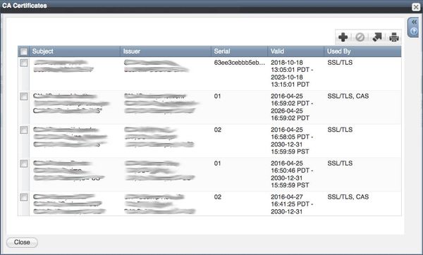

  2. Navigate to Grid à Grid Manager à Toolbar à Certificates à Manage Certificates.
  3. Click on the ‘+’ button to upload the certificates from the Certificate Authority chain.
  4. If different from step 3, upload the OCSP CA chain from your OCSP responder.

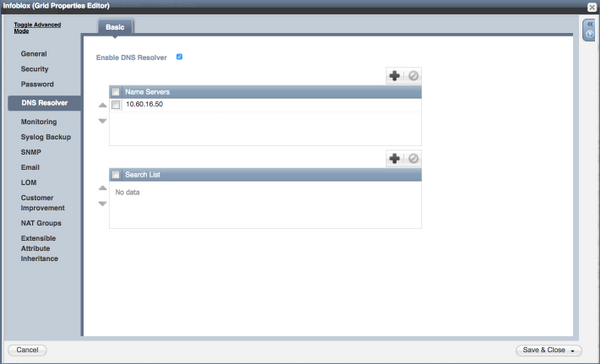

  5. Navigate to Toolbar à Grid Properties à Edit à DNS Resolver.
  6. Click on the button to enable DNS resolver.
  7. Click on the ‘+’ button to add the IP address of the Active Directory server.
  8. Click Save and Close.

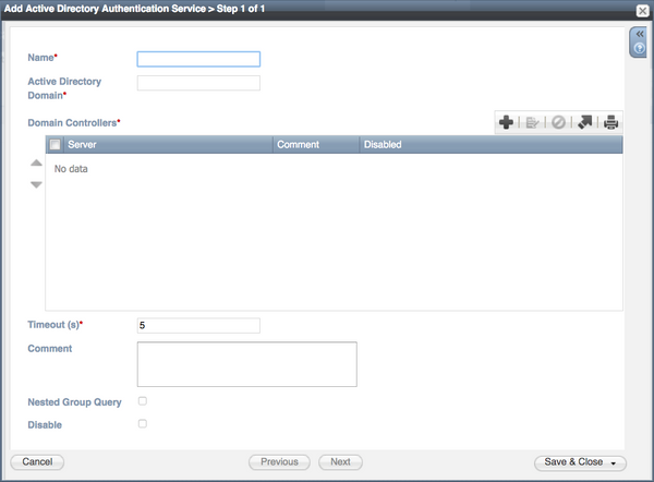

  9. Navigate Administration à Authentication Server Groups à Active Directory Services.
  10. Hit the ‘+’ to add an entry.
  11. Enter the name of the Active Directory Service.
  12. Enter the name of the Active Directory Domain.

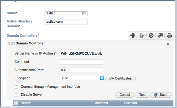

  13. In the Domain Controllers section, click on the + button to add a server. Use the fully qualified domain name of the server.
  14. Change the encryption to SSL.
  15. Click on the ‘test’ button. If it is successful, click on the ‘add’ button.
  16. Click ‘Save and Close’.

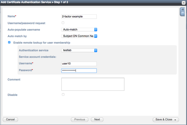

  18. Click on the ‘+’ button to add Certificate Authentication Service.
  19. Add a name for the service.
  20. Uncheck Username/password request.
  21. Click on the button to Enable remote lookup for user membership.
  22. In Authentication service, add the name of the active directory service.
  23. Add the username that was created in AD server for the Infoblox appliance to log into the AD server. The username is a service account. The service account user needs to be able to search the user attributes to get the member of objects.

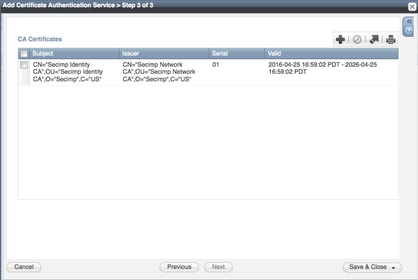

  31. Click on the ‘+’ button to add the CA certificates from the certificate store that will used to authenticate users.
  32. Click save and close.

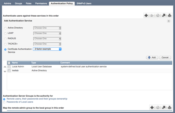

  33. Navigate to Administration à Administrators à Authentication Policy.
  34. Click on the ‘+’ in Authenticate users section.
  35. Click on the Certificate Authentication Service button.
  36. Choose the Authentication Server Group that was created before.
  37. Click the Add button.
  38. You should get a message stating 2-factor authentication enabled.
