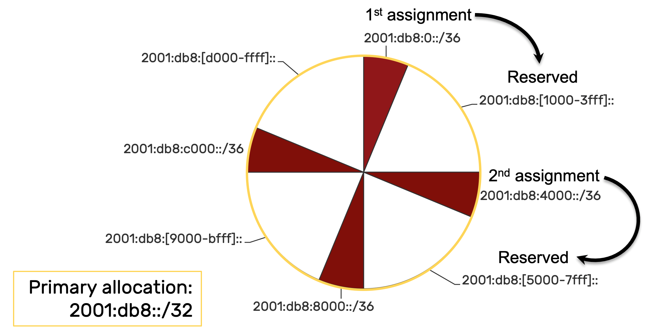

Here’s a visual example of sparse allocation to hopefully make the concept a bit clearer. Imagine that an organization starts with a /32 of IPv6 address space—in this example the reserved documentation prefix of 2001:/32. The organization could be a Regional Internet Registry like ARIN (where the /32 would come from their much larger pool of a /12). Each entity being assigned prefixes from the /32 by ARIN would be some smaller organization requesting address space from ARIN.
Or the primary /32 allocation could belong to a service provider that has been allocated the /32 from an RIR. In that case, the entities receiving subsequent smaller assignments from the service provider would be their customers.
Another possibility is that the primary /32 allocation could belong to an enterprise. In that case, the entities might represent internal assignments to corporate network locations or regions.

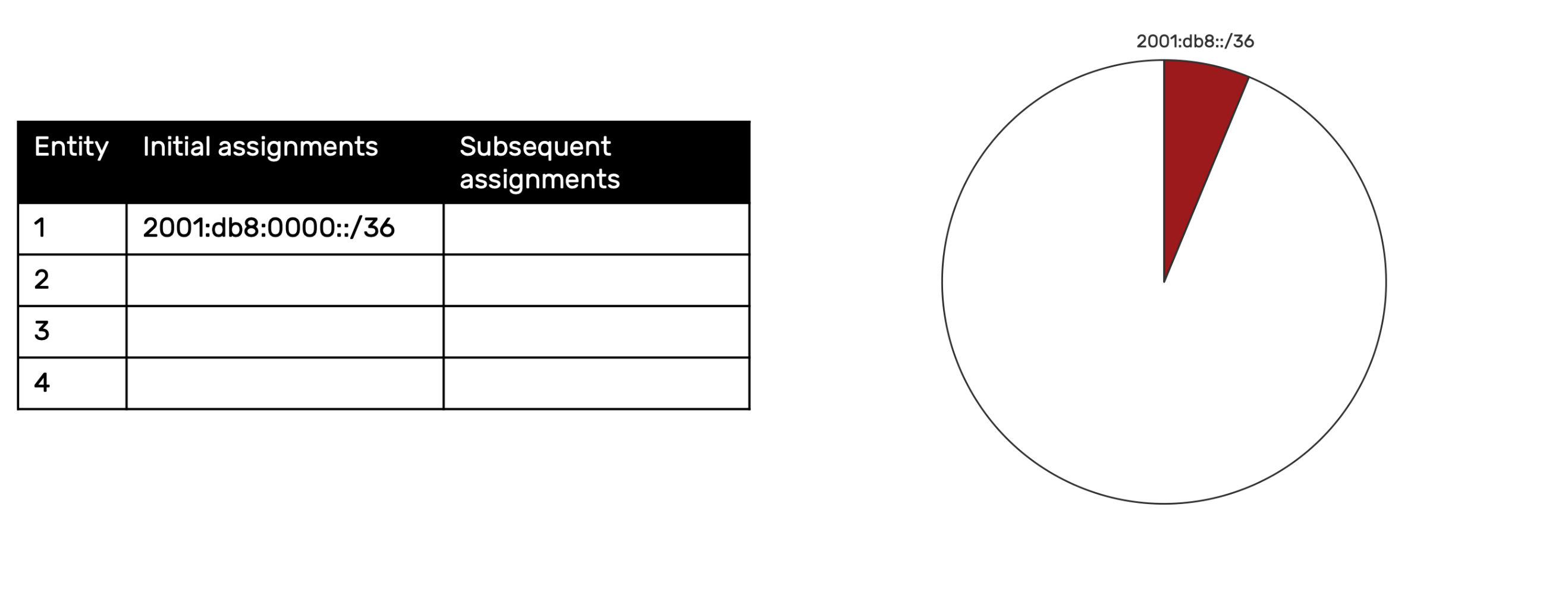

In any of the above cases, the sparse allocation method would be to assign the first available /36 (e.g., 2001:/36) to the entity while reserving some contiguous amount of address space. In our visual example, the equivalent of 3 additional /36s have been held in reserve for each of the first and second entities.
Let’s look at each step of the sparse allocation method in this example. The initial assignment to entity 1 is 2001:/36. Keep in mind that because of zero compression rules for IPv6 addresses, the prefixes for the /32 and the /36 might end up looking exactly the same, but for the CIDR notation at the end of the prefix indicating the prefix length (e.g., 2001:/32 and 2001:/36).
You may notice that in the example graphics, I break this rule in a couple of ways. For instance, in the above graphic, to assist in highlighting the relevant nibble for the /36, I included one zero. In the graphics below, I included four zeroes in the first prefix example in the table column to help maintain a consistent prefix width for visual purposes. Technically, both these examples should be zero compressed to the minimum length (e.g., 2001:/36).
If you read part one of this blog, you may want to briefly recall how the next available allocation method works for comparison purposes. If we were using it, the next entity would get the next available /36, or 20011000::/36.

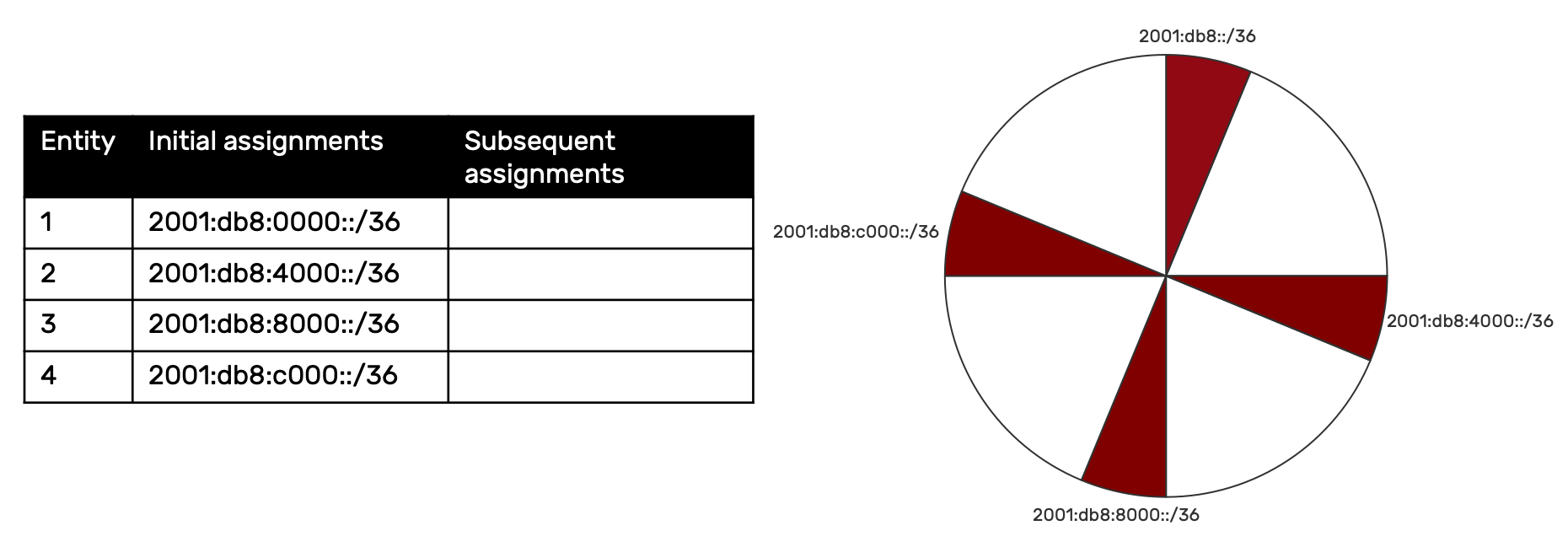

By comparison, sparse allocation increments the most significant (leftmost) bits in the nibble. Note that if this is done strictly, by incrementing one bit at a time, you’ll observe that it results in a sequence that skips the intervening prefixes in a way that isn’t necessarily intuitive. For example:
0 0 0 0 = 2001:/36 (or with the relevant zero included 20010::/36)
1 0 0 0 = 20018000::/36
0 1 0 0 = 20014000::/36
1 1 0 0 = 2001c000::/36
etc.
We can then reorder the assignments according to their natural decimal order to better align with our entity list order:

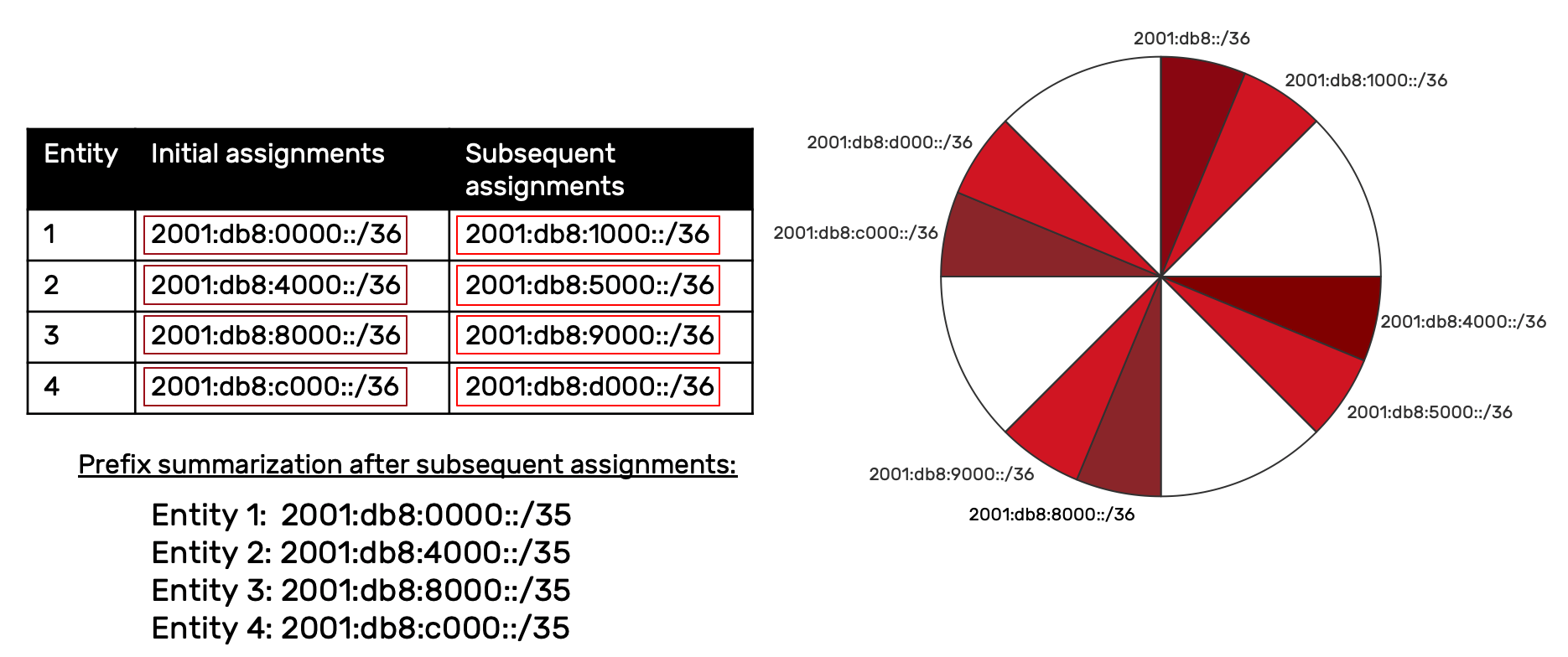

Remember: the contiguous characteristic is definitional for sparse allocation! For example, by continuing to contiguously assign the remaining /36s to the respective entities, we get the following:
When all the IPv6 address space available in the primary allocation is assigned and the entire /32 consumed, each entity will have 4 contiguous /36s. As the above example suggests, these 4 /36s could each be summarized as a single /34. For example:
Entity 1 summary: 20010000::/34
Entity 2 summary: 20018000::/34
Entity 3 summary: 20014000::/34
Entity 4 summary: 2001c000::/34
This summarization results in no more than 4 entries in the upstream router. By comparison, using any other method could result in as many as 16 routes. That should help demonstrate why sparse allocation is the method of choice for service providers and Regional Internet Registries (RIRs).

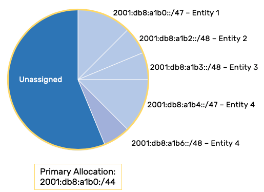

In this example, different entities are requesting the number of IPv6 address prefixes they have determined they need. To tailor the example to an enterprise, these entities could be functions or departments (e.g., data center, manufacturing, IT, etc.) responsible for their own networks and in need of address space.
Entity one determines it needs more than one /48 but not more than two. The assignment that would “best fit” that request is a /47 (although it might be odd that a site may outgrow a single /48 and need two). Entity two needs not more than one /48 and receives a /48. Entity three also needs not more than one /48 and receives a /48.
Entity four determines it needs the equivalent of three /48s. Binary dictates that the prefix size has to be some integer power of two, so the assignment that would best fit entity three’s requirement would be one /47 and one /48.
All of this is perfectly reasonable in terms of meeting the basic requirement of a) having enough address space and b) assigning it according to current needs. But veteran network folk can spot the complications immediately.
For one thing our routing table will have the following entries:
2001a1b0::/47 – Entity 1
2001a1b2::/48 – Entity 2
2001a1b3::/48 – Entity 3
2001a1b4::/47 – Entity 4
2001a1b6::/48 – Entity 4
Of course these can always be summarized as the primary allocation prefix of 2001a1b0::/44 but within the immediate routing domain, we have to operationally deal with different prefix sizes, some entities having one prefix in the routing table with others having multiple entries.

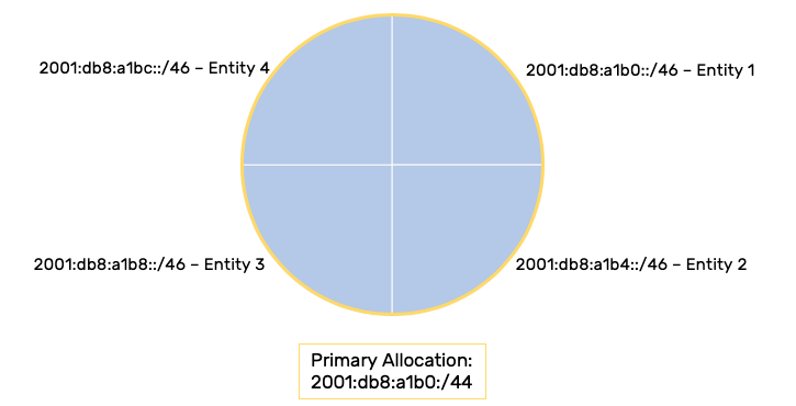

By comparison, choosing the entity with the largest /48 requirement and assigning all the entities that size prefix allows us to meet the prefix/address space needs of each entity while reducing both the size and complexity of the routing table:
2001a1b0::/46 – Entity 1
2001a1b4::/46 – Entity 2
2001a1b8::/46 – Entity 3
2001a1bc::/46 – Entity 4
You’ll notice also that this allows us to use the next available allocation method.
This is typically the point where anxiety about “wasting” address space ramps up. “Entities 2 and 3 only need a /48! Why am I giving them 4 times that amount?!” The answer is that the practically inexhaustible supply of IPv6 results in the ability to make addressing and address plan choices that favor operational ease and efficiency over mere conservation for its own sake (a trade-off simply not available to us in IPv4 given its limited/exhausted supply): e.g., fewer routing table entries and greater ease of identification of network assignments—especially where allocations strictly conform to nibble boundaries (unlike our example immediately above).
