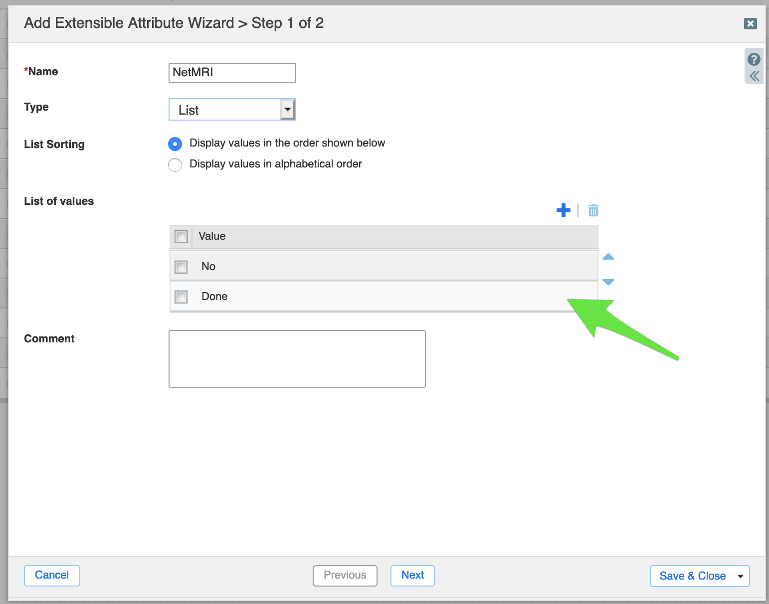

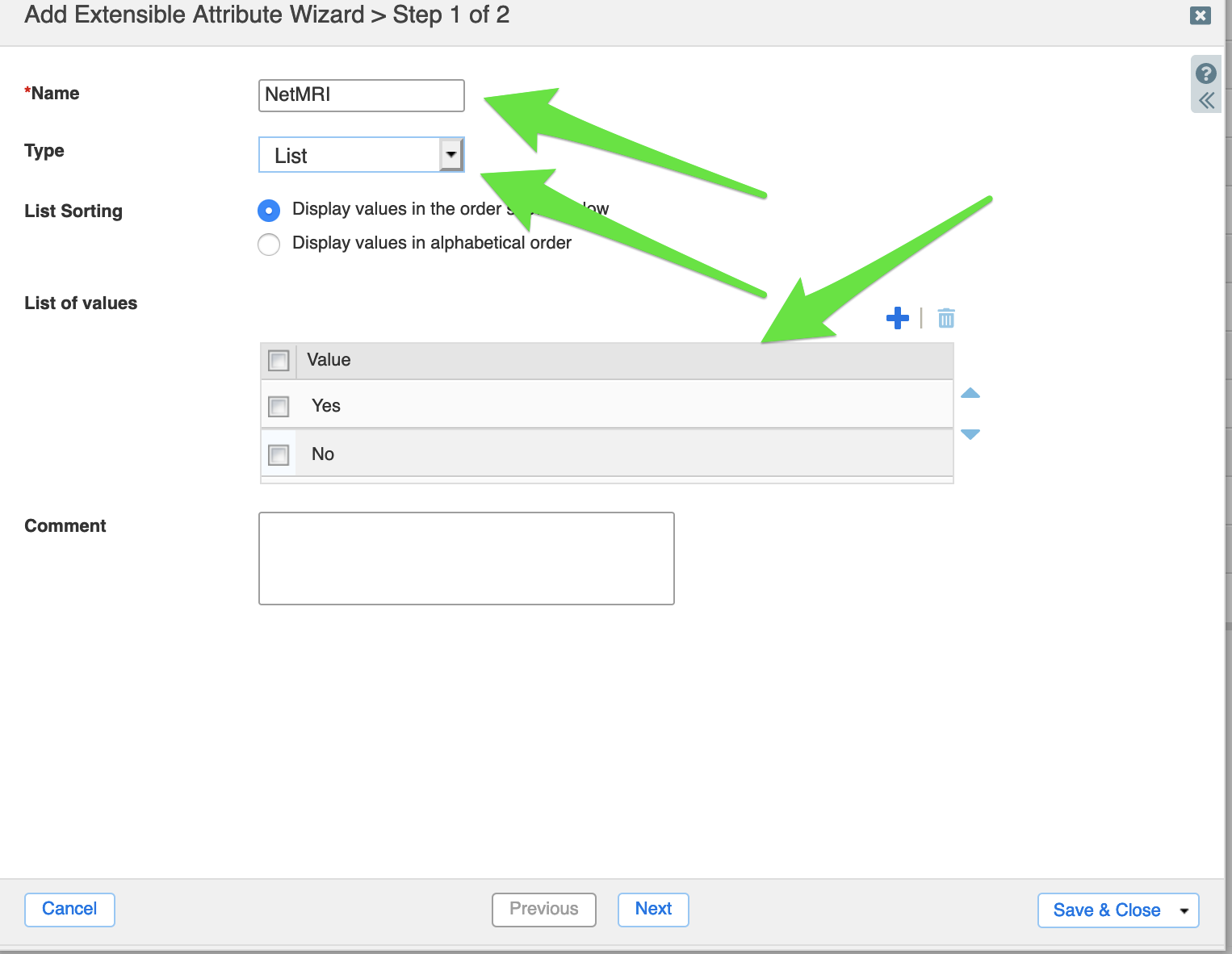

Creating and Using the Extensible Attribute
Log in to Infoblox IPAM, click on Administration -> Extensible Attributes -> the “+” to add a new EA. We will name it “NetMRI” and set the type to “List”, add the Values “Yes, No, Done” then click “Save & Close”

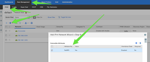

Now we create the network in IPAM under Data Management, IPAM, Click the “+” button.
At the end of the wizard you will be prompted which Extensible Attributes you want to assign to this network. Add the “NetMRI” EA and set the value to “Yes”. Later our automation script running on the NetMRI appliance will be look for all networks were the EA “NetMRI” equals “Yes”

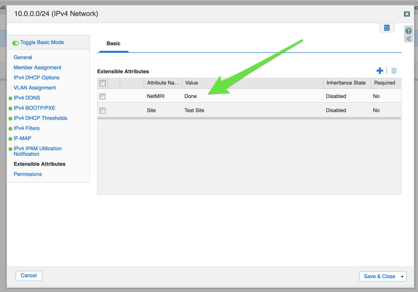

The 3rd call uses “PUT” to update the NetMRI EA on the IPAM side to change the value from “Yes” to “Done”

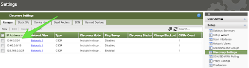

3. Results

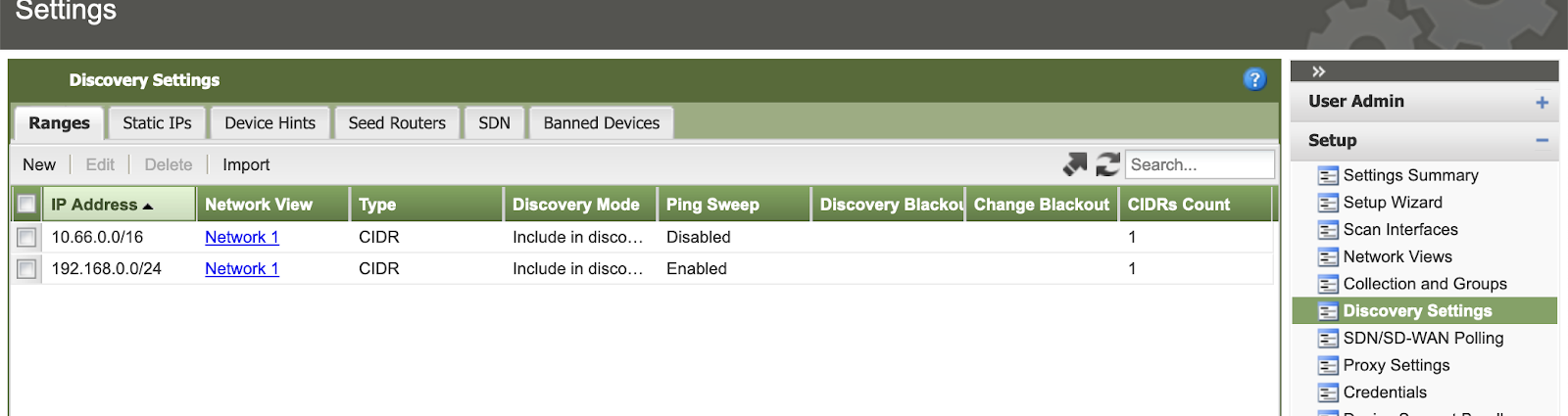

Now let’s run the script and see what happens.
Here is in NetMRI -> Settings -> Discovery Settings -> Ranges
As you can see the network from NIOS was added
Now let’s check IPAM for the network EA, to see if it was updated

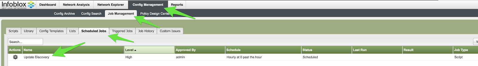

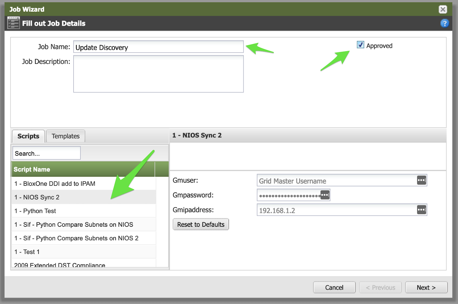

In order to keep track of networks as they are added to IPAM we are going to add it to NetMRI as a scheduled job to run once an hour.
Config Management → Job Management → Scheduled Jobs → +
Choose the Script on the right side(mine is called “1 – NIOS Sync 2”), give it a name and Approved

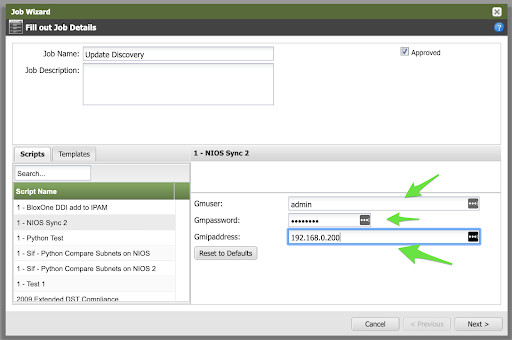

Now we need to add the User account, Password and IP/DNS name.

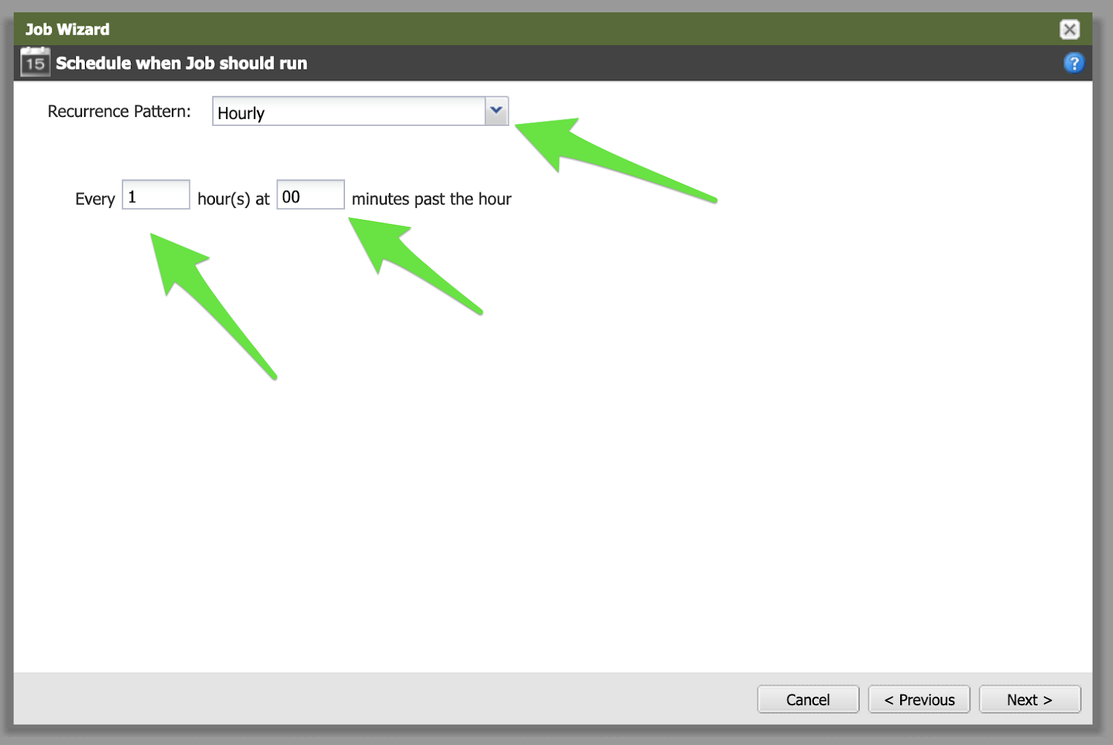

Now we set it to run every hour on the hour
You can find the scheduled tasks in the NetMRI UI under Config Management, Job Management, Scheduled Jobs.
