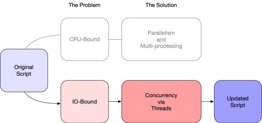

Turbocharge your Infoblox RESTful API calls (Part 2). In this second article of the Turbocharge your Infoblox RESTful API calls series, we'll take our synchronous Infoblox WAPI automation script and demonstrate how we can improve it by using concurrency to make it run faster. In this article we discuss what concurrency is, the pros and cons for using it in development, and how to implement it in our automation scripts. Recall that at a high level, scripts can be CPU-bound and/or IO-bound. Scripts that are IO-bound are best refactored using concurrency techniques while CPU-bound scripts are best developed to take advantage of parallelism. Since our script is IO-bound (in the sense it has to wait for the network), we'll focus on concurrency in this second article.

In this second article of the Turbocharge your Infoblox RESTful API calls series, we’ll take our synchronous Infoblox WAPI automation script and demonstrate how we can improve it by using concurrency to make it run faster. In this article we discuss what concurrency is, the pros and cons for using it in development, and how to implement it in our automation scripts. Recall that at a high level, scripts can be CPU-bound and/or IO-bound. Scripts that are IO-bound are best refactored using concurrency techniques while CPU-bound scripts are best developed to take advantage of parallelism. Since our script is IO-bound (in the sense it has to wait for the network), we’ll focus on concurrency in this second article.

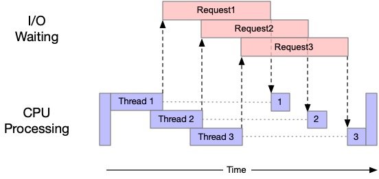

The following graphically depicts how the script would execute, showing a much larger number of requests appearing to be simultaneously launched, with results being handled and returned as they are completed.
