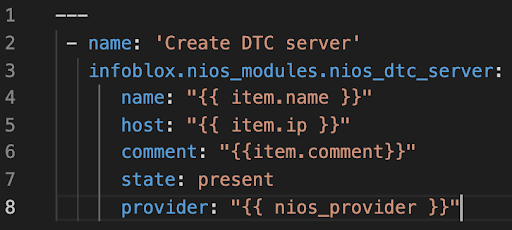

DTC Server Task
Here we are going to take a look at “task_dtc_server.yml.”
As you can see above, I made “name,” “host,” and “comment” variables, and that will read the values from the “data.yml” file. With Ansible, when you use “item,” it’s reading a list of variables from a YAML file.

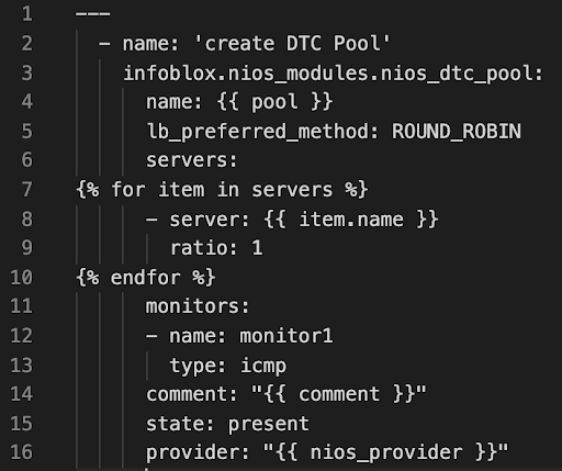

To create the “Pool,” we have to leverage Jinja2 Templates. For example, here is the Jinja2 template “temp_pool.j2.”

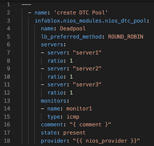

We are reading “name” for the pool and “servers” from the data.yml file. When you run the “create_everything.yml,” it will create a new playbook called “c_pool.yml” that looks like this.
Then execute the “c_pool.yml” for “Pool” creation; now we have the Servers and Pool time for the LBDN creation.

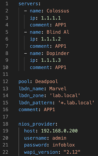

Data File
Here is the “data.yml” layout
As you can see, this is where we get all the data points that we used above in each “task” file. Let’s see how we call the “data.yml” and all the “tasks” from one playbook called “create_everything.yml.”

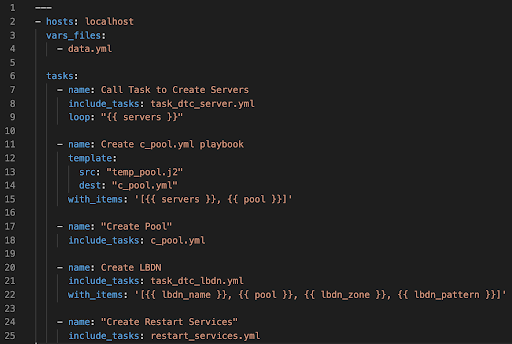

We are going to look at the file “create_everything.yml.”
The first thing to notice is that we use “vars_files” to read the “data.yml” file into the playbook. Next, we have “included_tasks” under “tasks” that will run each instance of the “task” files for us. For example, in line 11, we will create “c_pool.yml” from a “template.” The last “task” I did not cover in this article is “restart_serverices.yml,” which is self-explanatory.
